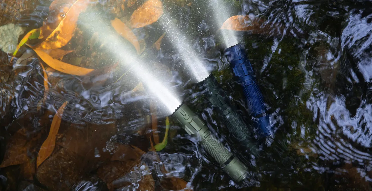

Warrior Ultra Tactical Flashlight
Experience the pinnacle of tactical lighting with 2,500 lumens of peak output. Features a durable unibody design and advanced thermal management.

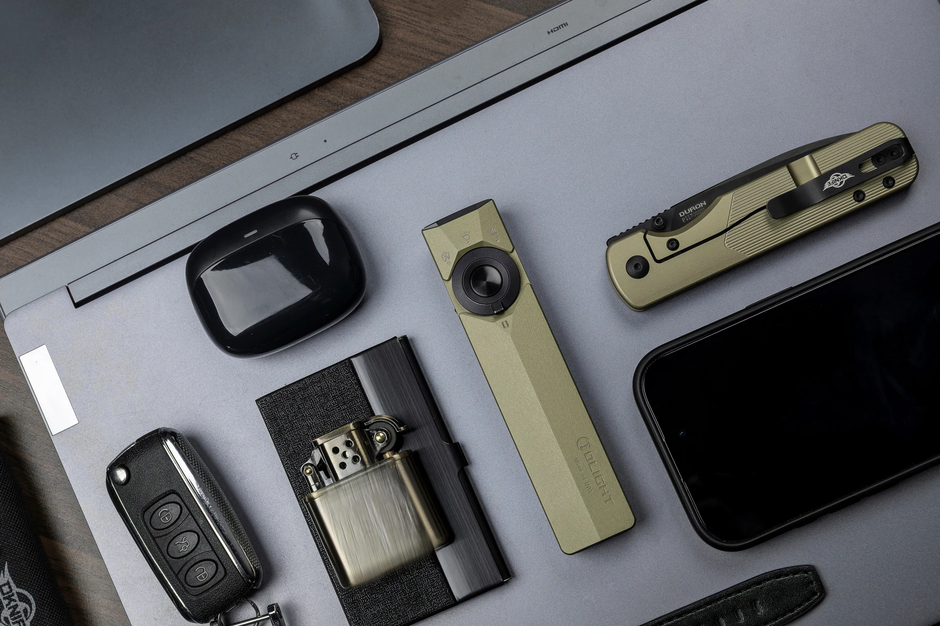

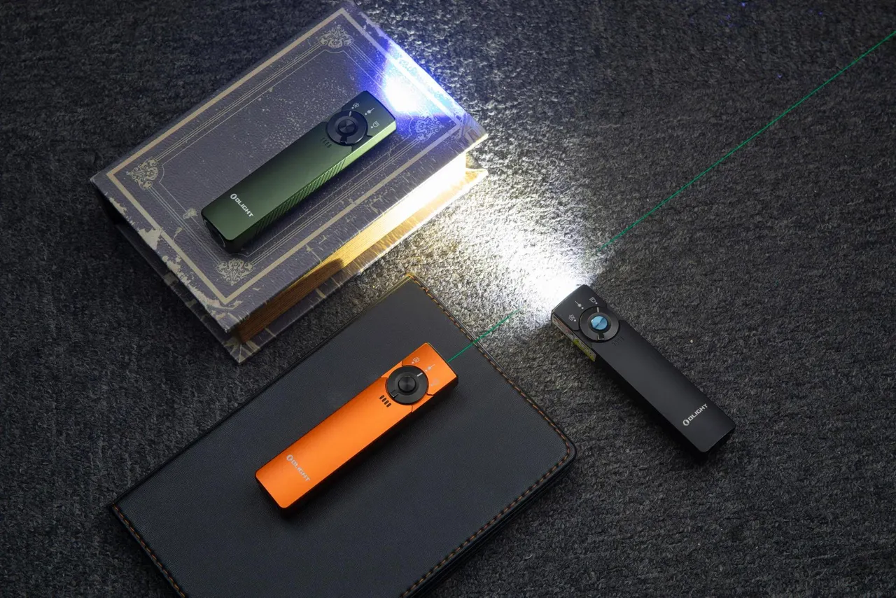

ArkPro Series Flat EDC Flashlight
The ultimate flat EDC tool combining a powerful white light, UV, and green laser. Slim profile with high-transparency glass lenses.

Arkfeld Pro Flat EDC Flashlight
A triple-light source EDC masterpiece. Delivers a guaranteed 1,300 lumens with precise optical control and runtime transparency.
